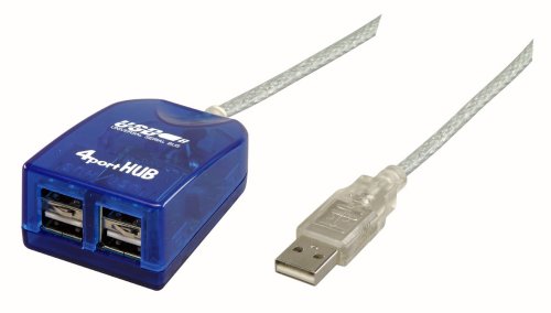

With BIOS revision F8, no wireless keyboard is detected if the reciever is connected via USB Hub. It is detected if connected directly to motherboard.
USB Hubs are used to make the dongles point in keyboard direction and not to wall - this increases the range a LOT and to spare front ports(if present).
I have a passive Hub from Skymaster, this one: http://ecx.images-amazon.com/images/I/310oqaOjltL.jpg
Both mouse and keyboard reciever are connected to it.
With BIOS F7, everything works.
With BIOS rev F8, 2.4Ghz wireless keyboard only works if it is connected directly to motherboard. Recievers on usb hubs(passive, maybe active are affected too) are not scanned. My front USB panel has 1port on motherboard-1port front mapping, so it works for front panels too, unless they are built like a hub(multiplyer)
