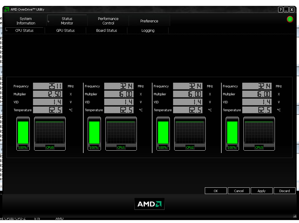

I have a GA-880GA-UD3H
With an AMD x3 450 rana chip with the unlocked 4th core.
Everything tests out great.. can run PRIME..  no problem.

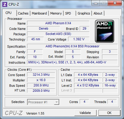

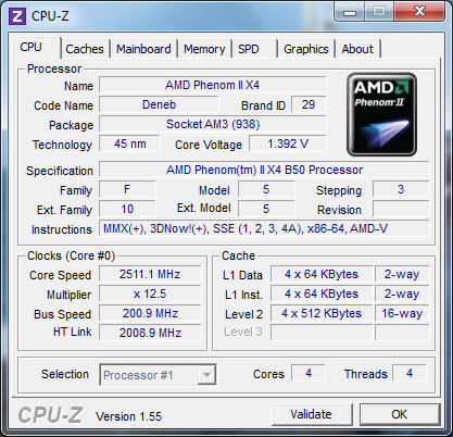

But core0 Multiplier keeps dropping down to x12.5, yet 1,2 and 3 are all running at x16.
I turned off quiet&cool, as well as the power management settings in the bios..
What am I missing?
Core0
Core1 (same for 2 and 3)
Overdrive while running Prime95
Also Temps in Overdrive read in the low to mid 60s (°C) while under full load yet in easytune it's reading 44°C

First of all, I'd use something more reliable for temps. CoreTemp or CPUID HWMonitor should do the trick. Secondly, what's your CPU temp? I'm kinda surprised that you can monitor core temps when you've unlocked the CPU.
When does it clock down? Is it random or, say, under stress?
I think there was some core control option in the ACC menu, too. Maybe look in there.
Lastly, this could also be bios reacting to instability. Or just a quirk of an unlocked processor.

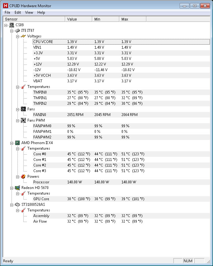

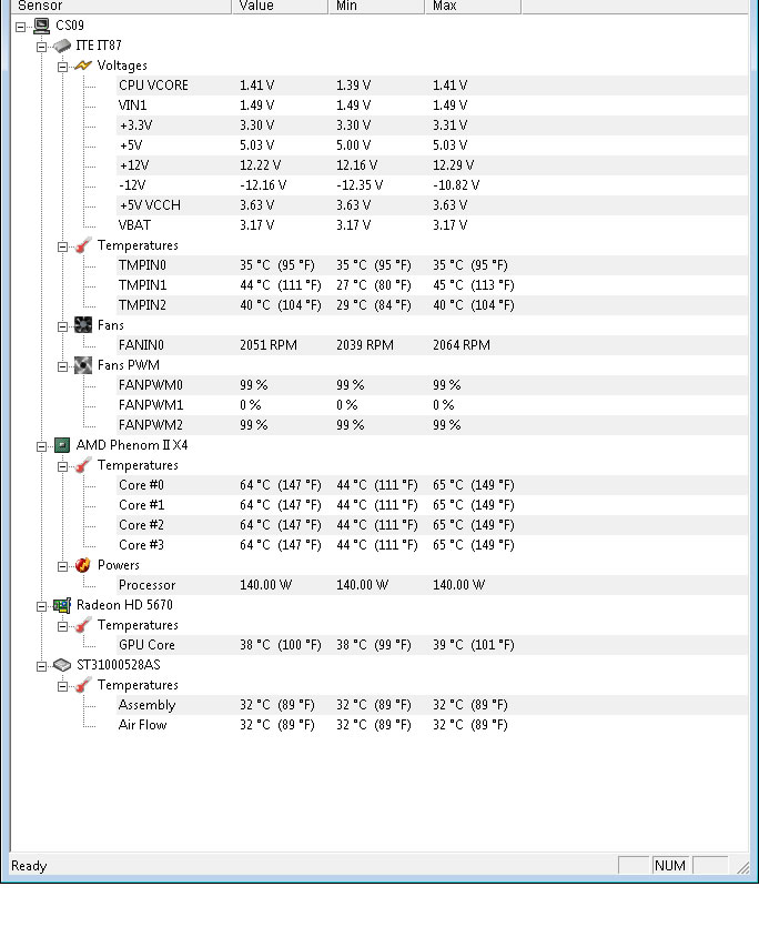

I downloaded Hardware Monitor to see what I can get out of it..
Before running prime.
Then after running Prime less then 5 min
Basically I just want to know what I can trust and should I be worried about these core temps running Prime?  I haven't even gotten to OC yet but I'd like to make sure I've done everything I can before I even try.

Anyway.. TMPIN0 never changes..Is this outside temp?
then TMPIN1 inside the case
then TMPIN2 being the CPU? (is this the most important to watch or is it the core temp?
Thoughts?

Quote
As far as I am aware TMPIN0 is unused.

So what about TMPIN2  Assuming it is CPU temp
and my core temps?
This seams high for core temps..   I am testing a original Phenom x4 the same way and cores never reach above 55°c on a bone stock setup.
EDIT (I just read core temps aren't actually measured this is just a Calculated number)
TMP's don't match up at all so I can only assume these are different based on the MB manufacturer.

I have poor people's board - a 770 chipset.
In my case ( pardon the pun ) - TMPIN0 - "system" temp
                                                 - TMPIN1 - CPU temp
                                                 - TMPIN2 - no sensor, 79-82 degrees reading
I'd say that with your board TMPIN1 is CPU, if you're running on air. Why? It's cooler than system temp when idling and higher when under load. You have some nice inside temps, btw. With my PC the difference at idle is quite staggering with CPU being 27 degrees and case being 38 degrees. From what I remember the System sensor is near the graphic's card so that could be why. Especially considering the fact that I'm running my GPU at 25% fan speed at idle.
I wouldn't worry about core temps. As long as your CPU temp is fine you're ok.  Run IntelBurn Test for 15-20mins and you should reach a few degrees more on the CPU. I'd use that as my indicator of how much overclock is too much. To be safe, it'd be best to not exceed 60 degrees under load. Preferably stay below 56 but you have to remember that your CPU will likely never see temps like ones in Burn Test during normal use.

Perfect.. This is exactly what I was trying to know / figure out.
I wouldn't say my board is a Rich man's Board.. it was under 100 with the rebate..
I think it had the most features for the price, that is why I went with it..
Hind site I might have gotten a board that can do 2 Video cards at 16x...
But otherwise.. it's all good..
I really was worried about those core temps at first..
But then the more I read about them being calculated, and once unlocked that they don't read correctly..
I felt better..
THANKS!
Now.. do you have any clue why Core 0 lowers the multiplier even though Quiet&Cool is off.. All power Management is off.. and C1E or whatever that other setting was is also off..

Read my first post in this thread again.
Other than that, you could try to overclock from OS level. That's what I've done.
You can use K10Stat for that. Download it and see if this problem persists there ( lock a p-state and see if all cores are running right ).
Here's a guide on how to use it, download too ( it's for undervolting but the mechanics are the same ):
http://aspiregemstone.blogspot.com/2009/06/k10stat-amd-griffin-processor.html
edit:
Forgot your CPU isn't a BE. Then I guess you can just try and see if core 0 multiplier will go down with K10Stat. Just lock it at the right p-state and run a stress test. Maybe give it a little more voltage than stock as that could be the reason.
